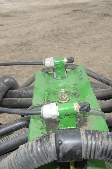

John,
I had similar idea...but I plan to bring those little relief valves in also, along w/the pressure gauge. I'll make a little plate or box to hold those items. This yr we split the airlines near the hitch & added Schrader valves to fill w/airhose from the outside so we didn't have to drag it in the cab. You just check the Schrader valves w/conventional tire gauge.
