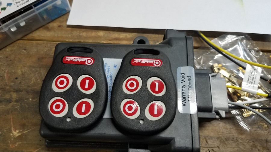

I called and talked to him and ordered the 2 function latched remote with 2 key fobs.

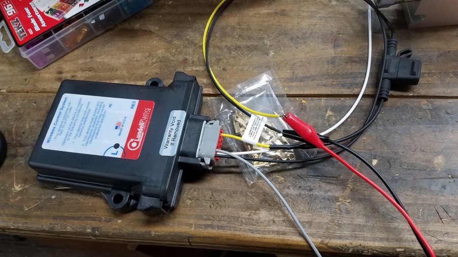

I had some additional questions on total acceptable amperage for the wireless unit and Matt walked me through it via email on the total amount of current the device could handle and also gave me a heads up that he has in the past saw an issue where an Enviropac motor could stall or lockup and send a spike that would overload the remote control.
I emailed him a rough drawing of what I wanted to do and he marked out wiring up the Bosch style relays for the motor.

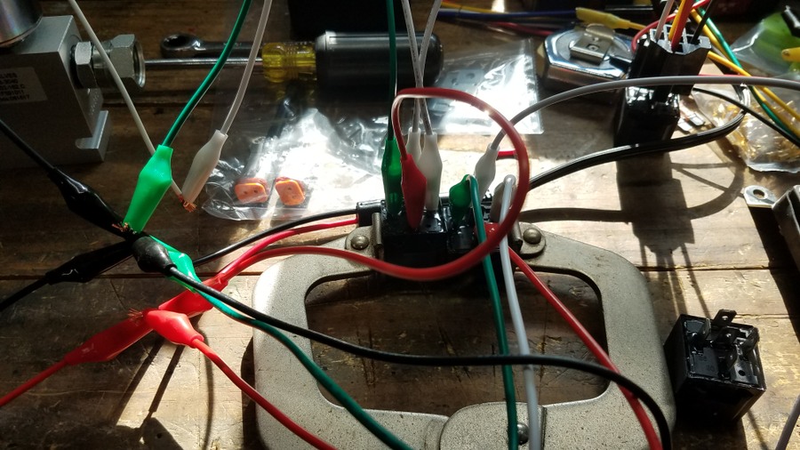

I ordered relays and a automotive box enclosure from Amazon and decided to wire both functions up to allow the relays to switch the loads to lessen any chance of damaging the remote control unit.

Here is the Lundell remote control unit.
2 key fob remotes

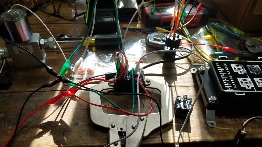

Here is the relay and fuse box from Amazon. Nice unit with rubberized seals for all the wires going in the back of the relays and fuse connections plus all the crimp on terminals that lock into the box. Nice gasket on the lid as well.
Here are the 2 relays being held gently by vice grips to make sure no terminals short across each other. A lot of jumper wires to make all the connections but pretty straight forward once you understand how they work.

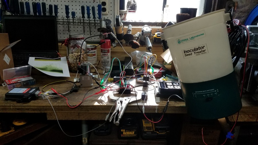

Overall view
Thought some might find this interesting on adding the remote controls.
This was set up on the shop bench and I walked outside over 110 ft away and could still hear both operating just fine with the remote controls.
