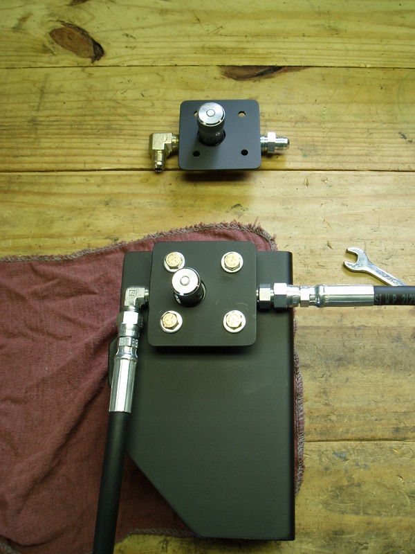

Anyhow the idea was to make a bracket that would accept either setup in the event I needed to go to the larger one or if I ever needed a spare. I got a couple pieces of hose made with flared fittings on each end. Then I got the 90° and straight pipe to flare adapter fittings I needed for each valve. Should I need to change the valve out the same hoses and mounting bracket can be used.

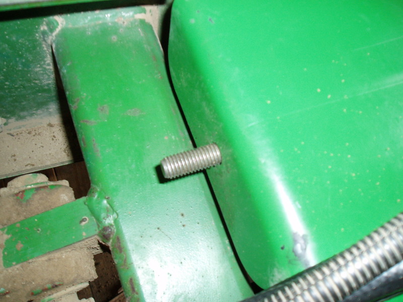

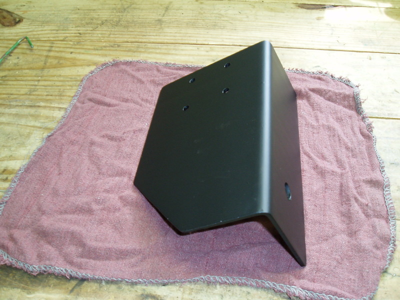

The planter tongue has a turned down lip that already had a 1/2" hole in it which looked like a good place to start for a bracket.
A nice piece of large angle that came off a J&M HT8 top wood beam support I shortened up to store my old 915 head on looked like a nice fit. Sets in place nicely with a single bolt and sits down on the cross tube the cylinder mount is welded to but still has a wide flange to mount the valve on. I notched the one corner to not stick out past the tube that the bottom cylinder support is welded to.

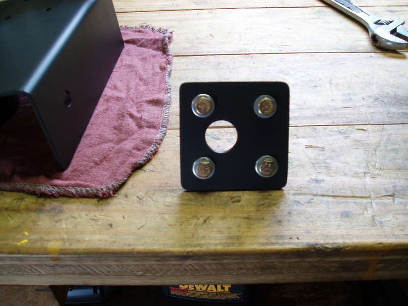

Next I needed to come up with a way to hold the valve down. At first, I thought about a strap across each end but with the offset knob one side does not have much room for a strap across it. I did not want to tack weld it so I made a plate and drilled the hole offset for the control knob to come through. Then drilled four 1/4" holes in the corners that would clear this valve or the larger one if I needed to switch. Then I made the same style plate for the larger valve so that they would be interchangeable on the same mounting bracket.

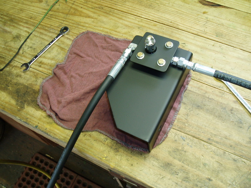

Here is the valve sandwiched between the bracket and the old down plate. I thought about using some rubber strips in here but decided as tightly as it was being held it will probably be okay ?
Here is the 1/4" valve installed and the 3/8" one with fittings ready to be substituted if need be or kept as a backup if not.
