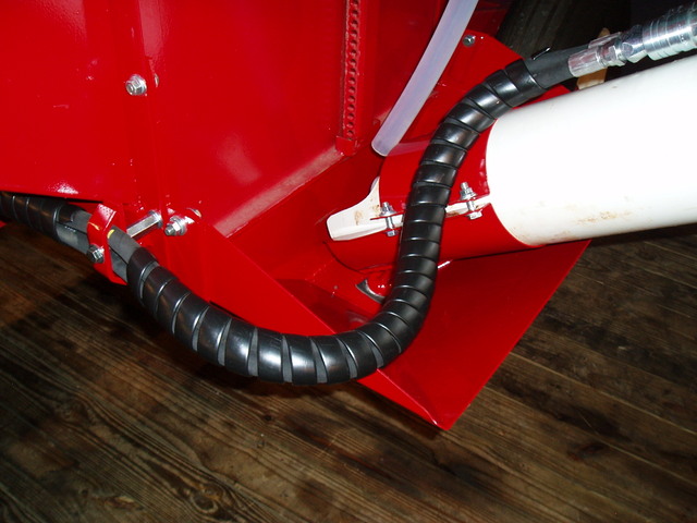

Doing some work on the planter, and I’ve always hated the way White just zip tied hydraulic hoses to the frame. What’s the NAT approved clamp to hold them to the frame?

These by far. Can get them at Princes Auto in Canada, no idea where you would get them in the US. Don’t know what the proper name is for them but if you could figure that out may be able to get them on Amazon

Most people call them Stauff clamps where or not Stauff makes them; kind of like calling all circular saws a Skill saw.
