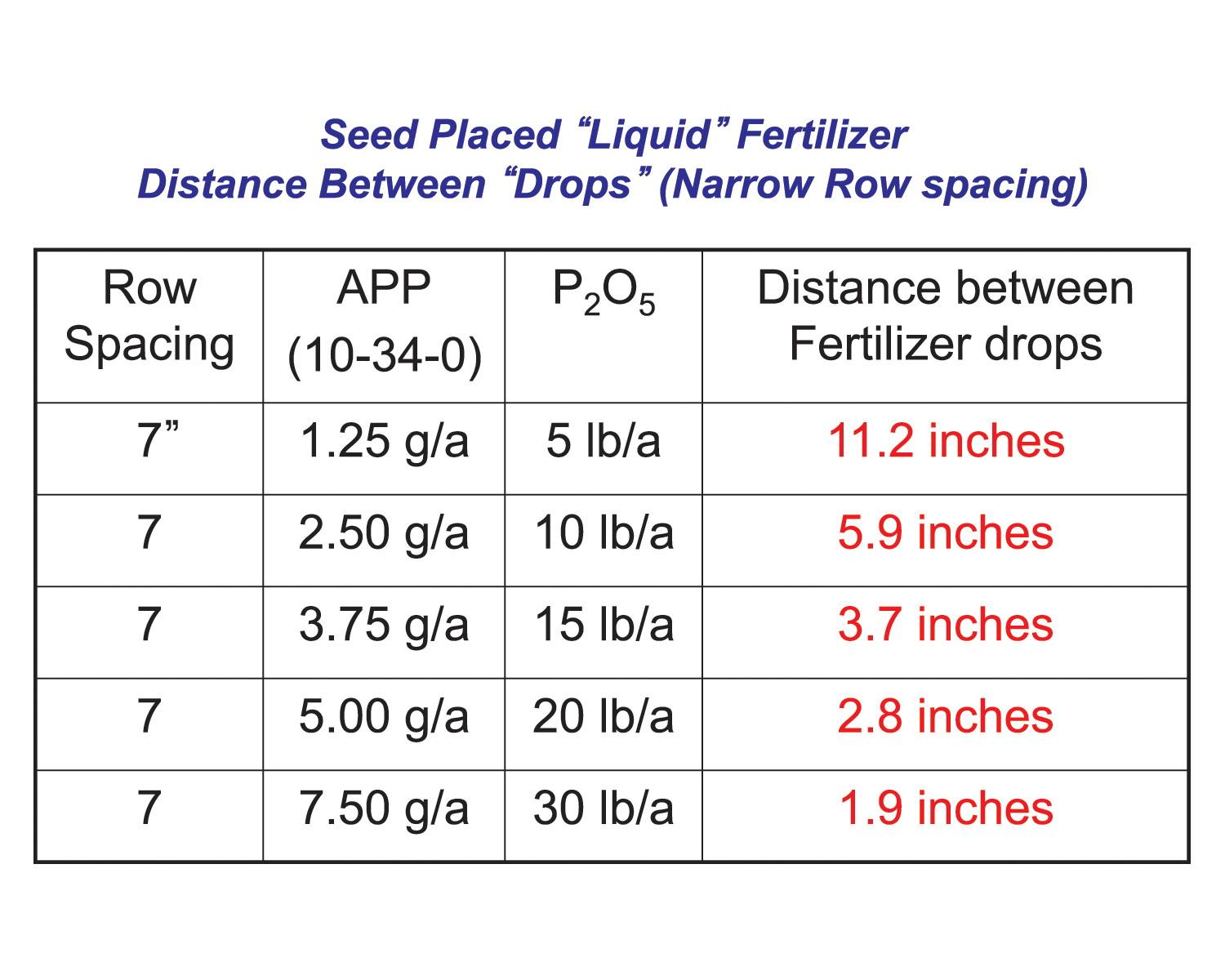

https://www.agvise.com/wp-content/uploads/2012/07/Starter-Fertilizer...
according to thsi, at 5 GPA on 7" they are 2.8" apart, so on 30 in rows, 30/7 = 4.28 more drops per inch
2.8"/4.28 = 0.625" apart
(Capture (full).JPG)
(91KB - 52 downloads)
