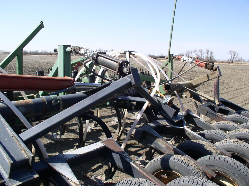

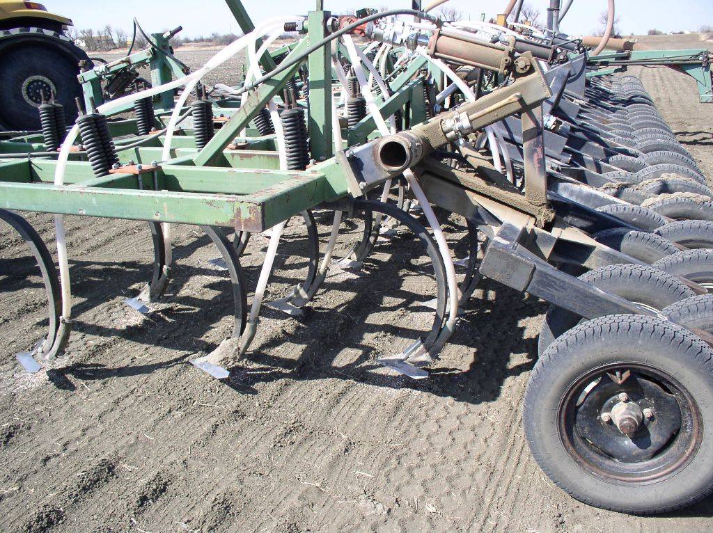

There wasn't much hi-tech about the old Concord air carts. Here's a couple shots of how I check for blockages.
 checking for blockages
 Filling check
Notice the nice uniform splotches of seed and fertilizer, slightly ahead and below the shovels. You need to turn off the fan and de-pressurize the tanks before you fill. When done filling and you have the lids sealed, just turn on the fan, walk back and give the feed roller crank a turn or maybe a turn and a half. Walk behind the seeding tool and check that there is a splotch for every shank. They will also be extremely uniform in size when all is working. If one is a bit smaller, it's time to investigate as there may be a small obstruction. I have noticed that the seed runs have a tendency to wear out obstructions quickly and are to a large measure, self-cleaning. Drove my seed truck through a small thicket of trees once and didn't have the tarp rolled out. When I started filling, I noticed a bunch of twigs in the filter baskets. They caught the lion's share but I could see that some made it into the cart. While seeding that load, I would stop every mile and check for blocks. Never found a one and never found any of the twigs either. Not wanting to push my luck, I now make it a point to roll the tarp before driving through thickets.
