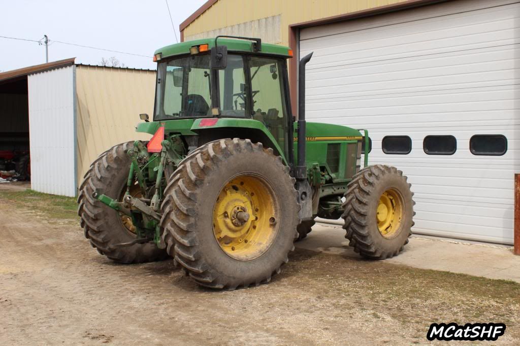

Hello All

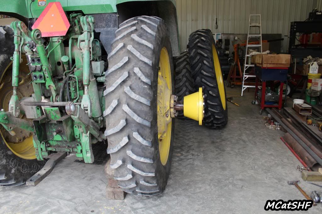

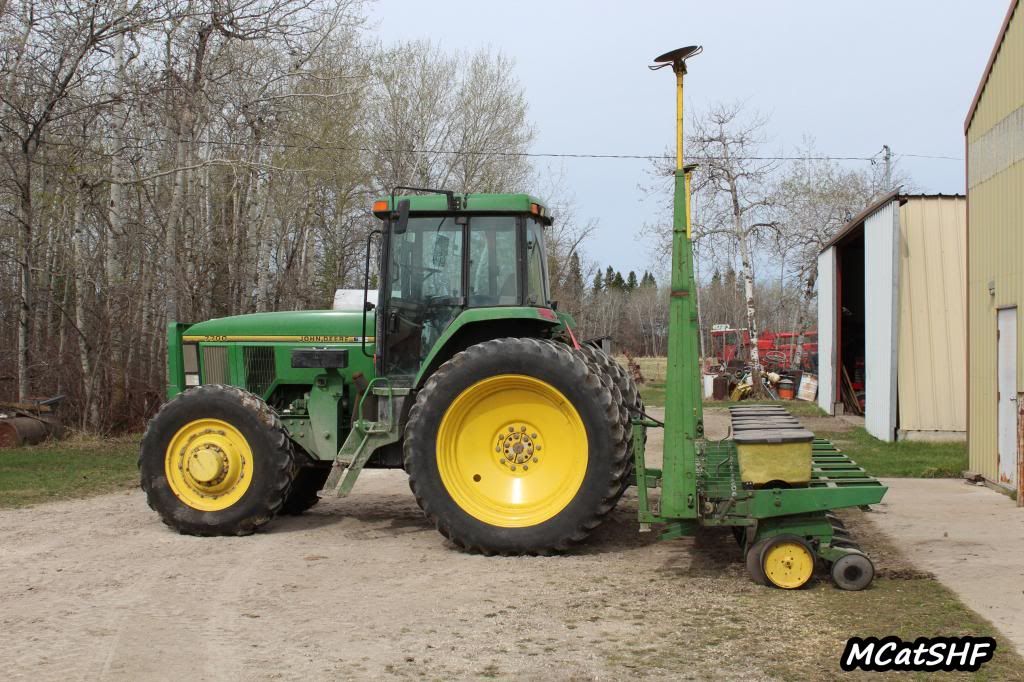

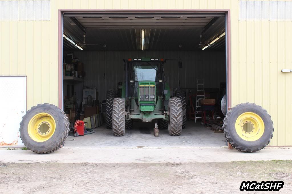

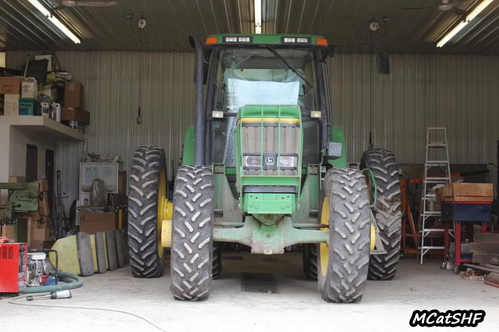

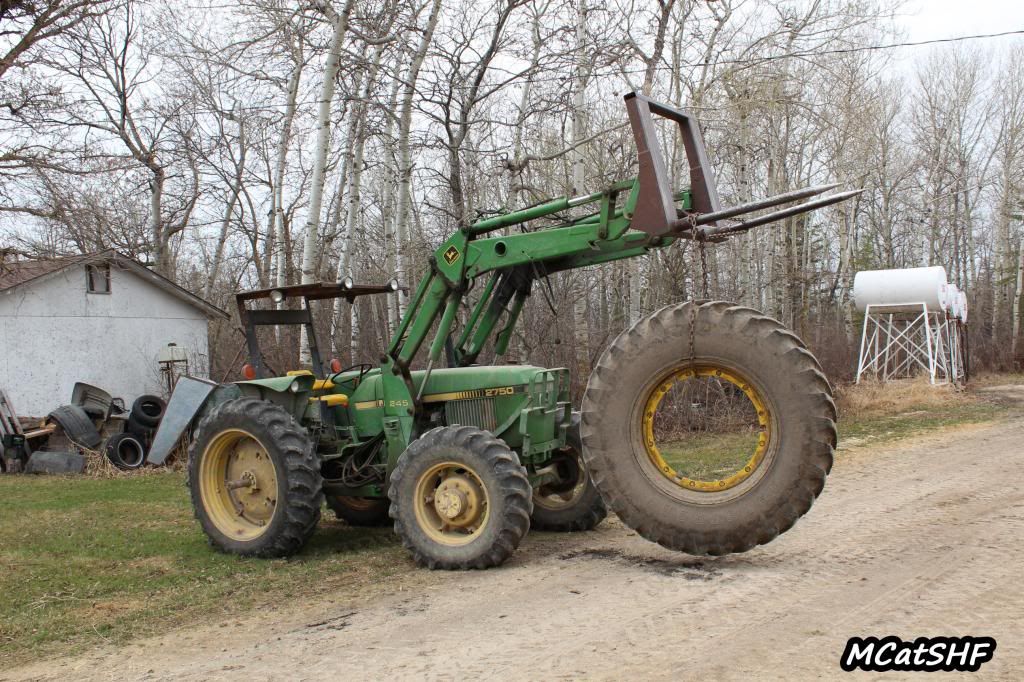

I figured that if I'm going to pretend to be a row-cropper, I might as well look the part. A few pics of me taking my cattle farmer wheels off & putting on my row-cropper wheels. This 7700 was set up for row-cropping originally with the extra wide axles. The second owner put wide singles on it & got mad & shortened the axles after he took out the shop door frame with it. Thank goodness he left them long enough that I didn't need hub extensions & am able to just use the dual axle hubs & wheels with maximum offset to get my 30" row spacing.
