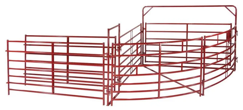

In your situation, I believe I'd stick with the two pen side by side setup you have, then add a 1/4 tub / alley / chute beside them. Have it where one pen feeds into the tub, and then they can exit out the chute and into the other pen. Remove the chute and the alley becomes your load out.
I'd look into some bigger posts for the perimeter. I like the panel angle for keeping things removeable for aesthetics and cleanout.
A 90 degree tub and a one panel alley ain't much, but it would be more than what you've got now.
https://tarterusa.com/nitropack_static/APKNOhVNYFYsogUfvaUwmsoSyHtCT...
