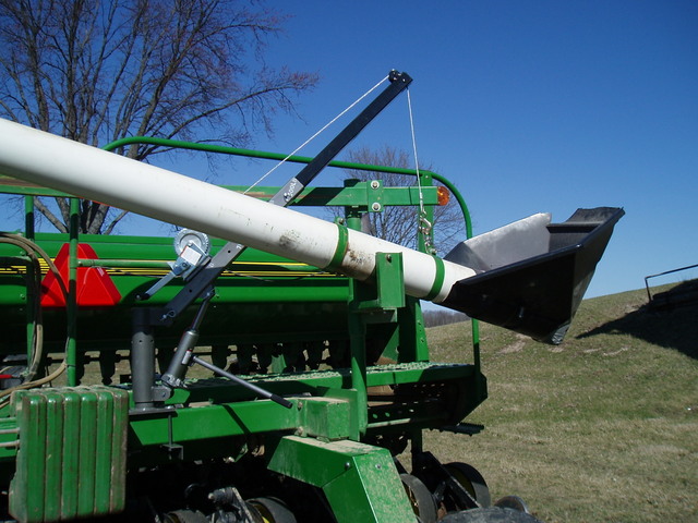

I used components from both the above ones on a 750 drill for handling the seed auger in and out of the cradle. Works really slick and fits like it was made just for this application.
