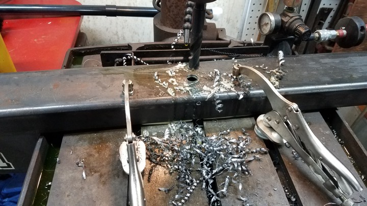

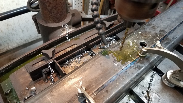

This is the setup I have. Uses air line to pull coolant/lubricant out of a 5 gallon bucket under the table.
Here is their website.
https://cedarberg.com/products/snap-loc/e-z-mist/
My table has built in reservoir with drain plug at the rear where it returns to the bucket.
A few of it in use.
