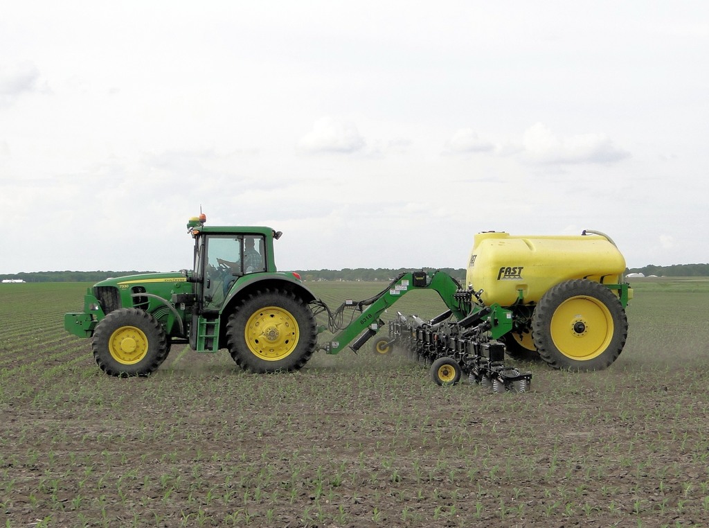

Photo below is sidedressing with liquid UAN (aka 32% N). Again, this is a 15 shank applicator that has 1.5x orifices on the end rows, therefore we skip one row when we make the return pass.
Below is a view from the cab of our NH3 applicator (JD 2510H). However, just behind it you see our UAN applicator. Both applicators are applying 1.5x on their outer shanks.
