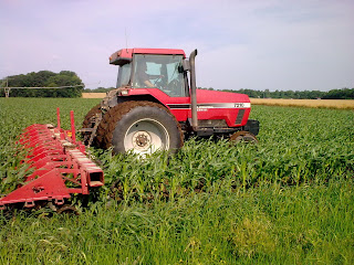

Why do North American farmers use duals so much?
We have a tractor that is 350hp at rated speed, all it does is cultivation and has a set of 710 (or is it 800?) tyres. It's never short of grip. Someone on here proudly (quite right, they're good tractors) showed a picture of his new tractor exactly the same as ours to pull his cultivator and it was shod with what can only be described as dual bicycle wheels. Very often others will post pictures of their tractor on duals and they tyres are rock hard, how do they even pull anything like that?
Several times I've seen pictures of tractors that started their working life if Europe and been fitted with large metric tyres. They someone has shipped them (often back) to the US and the person that subsequently bought it has fitted and additional set of wheels on it when the wide singles would have been working perfectly for the first number of years of the tractors life.
I'm perplexed.

Row crops. 710 or 800s run over a lot of corn when used to go back and spray or fertilize a standing crop. Also in most places In the US overall width isn't as big of a concern as it is in Europe for road travel. A wider wheel base rides smoother than a narrow one with single tires.

Cause we think it's cool! lol No JK.... less compaction is what I'm told.

I would think compaction is another issue. Bigger area=less compaction. I think this is why tracks are becoming more popular.

I like the flexibilty of doing row crop work with mine if I need to. If I had some big wide tires and my main sidedressing tractor dies or I want to sidedress and culitvate at the same time I'm SOL. Also for pulling planters especially in worked ground you want to be out of the tire track. 35" tires and 30" rows is not going to end well. The only tractor I can't do row crop stuff with is my Steiger and I see no reason to any way.

What width implements are they pulling "over there"? Here 40',50', 60' is common and singles just don't cut it.
We put triples on a tractor a few days ago. Ran out of traction with the duals front and rear and this was the cheapest and easiest way to remedy the problem.

I've got singles on a 115 horse tractor too and it does just fine getting the power to the ground. Maybe you need more power.
We run a STX450 Steiger sitting on 710/38 duals. Pulls our 8 leg 40" ripper. 25' wide. Take the duals off and it wouldn't get very far.

I'm guessing you are including some PTO-driven implement in your conclusion that you have enough traction with singles. I've seen a 360 (engine) HP tractor with triples in back and duals in front, fully ballasted, run out of traction.
Judging from the videos I see from Europe, you guys run really high ground speeds (is everyone an aspiring rally driver or is it all that techno music?), you have really heavy soils and you have serious width restrictions.
I'm guessing some of the big metrics would come close to having similar contact area, but they are no good for row crop work. Of course, we run duals and triples on articulated four wheel drives as well instead of big metrics like you do.
Perhaps there is some history involved as well. Back in the day, we could drop the duals for cultivation and haying and then put them back on for fall tillage. That made 140 HP tractors like the 4440 a lot more useful than if that had just had a fat set of tires on them.
Perhaps the bottom line is that we can adapt a tractor to more uses by running duals and triples than we can with fat singles- with singles, even if they have the same footprint, we are limited to tillage and today, mechanical front assist tractors in the US are used for a lot more than just tillage.

Different soil types I presume. I will take a guess you have soft fine soils. Implements pull easier and your deep lugged tires get a good bite. Here, deep lugged tires will actually roll the lugs as the ground is hard so the lugs don't sink into the soil... unless already worked.

Power = speed x pull. A 10m tool at 10 kph requires much less pull (and therefore less traction) than a 15 m tool at 6.6 kph.
So, I'm afraid tool width (and pull) IS pertinent.

I can't imagine not having duals for all the hills we have. Duals help a lot for stability and traction in are area.

Because of compaction, stability, traction. Why do you guys insist on running singles? Maybe you should try duals. The Ukrainians and Russians are buying our equipment for productivity maybe you can be a trend setter over there.

For pulling the Glencoe Soil Saver I use a tractor with less HP because it has duals and will hook up and pull.
My higher horsepower tractor with singles just tries to dig down to China.

They run big singles because they can't run duals due to road width restrictions. This is why you never see videos of wheeled articulated tractors accompanied by Super Eurobeat. If I recall correctly maximum width in some European counties might be 3 meters while in my area we can do up to 5 meters legally.

Posted 4/27/2014 15:26 (#3839413 - in reply to #3838914)
Subject: RE: Dual Wheels - Why?
Several others mentioned it, but this sort of application is the biggest reason.
(sidedressnh3-1.jpg)
Attachments sidedressnh3-1.jpg (143KB - 731 downloads)
