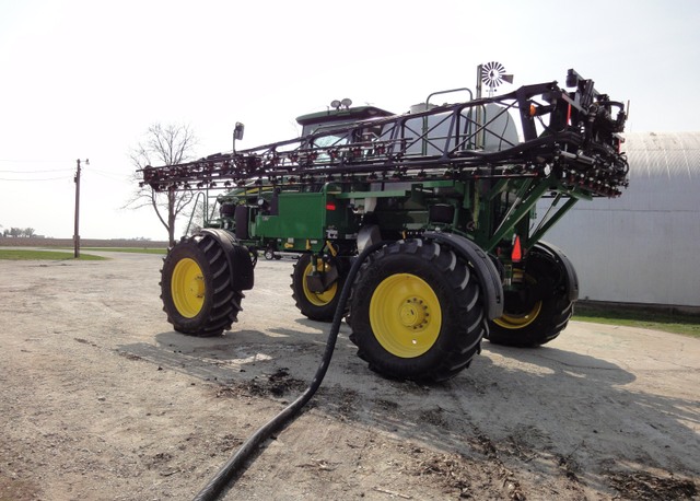

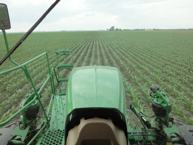

Posted 7/3/2010 19:56 (#1259422 - in reply to #1259017)
Subject: RE: 4730 John Deere Sprayers ?
I'm uncomfortable about spending your money, but....
Hydraulic tread
Dlx cab & air ride seat
15" spacing x 5-way nozzles
100' boom
3" fill (if it's an option)
Cold weather starting (I think that's an option).
All the lights JD offers for you. You'll appreciate that in night ops.
Auto Boom
Auto Trac
What I don't use? I sure didn't need the ss inductor. That just takes up space for me. Also, as I've mentioned before, I don't use or need foam markers. I don't have them, I'm just saying they're history...here. Not applicable for everyone, I realize.

Posted 7/4/2010 07:26 (#1259824 - in reply to #1259655)
I've used a pressure (venturi) inductor on the nurse truck for many years. Actually, I think it was Monsanto that came out with them many years ago for one of their dry herbicides back then. My early venturis were all steel. I decided a long time ago that I no longer wanted any type of dry material. like ATZ. I did use some Canopy this spring, but that's low-volume, minimal usage. We always mix on-site, never "hot" loads. Also, I was clear to say that I (me!) do not use the sprayer inductor and probably should not have ordered it. But, it's not a big deal. I just don't use it. In fact, I've never opened the cover on it. Maybe there's something in there I should check on. Byron asked what I could live without & I told him.
I'm not arguing, but I'm not clear on "why" you use multiple inductors. And...to answer another reply here....I've never poured any products in the top hatch.
This ACE Full-Drain Blow Molded tank is the best thing since sliced bread for a nurse trailer.
http://www.ohiovalleyag.com/catalog/index.php?main_page=product_info&cPath=48_49&products_id=1992
Edited by Ron..NE ILL..10/48 7/4/2010 07:39

IL Corn
Posted 7/4/2010 17:22 (#1260368 - in reply to #1259824)
Ron-
Looks like reinforced EVA hose running to your inductor cone?
If so, how does it hold up to Crop Oil or Roundup? Seems like we are replacing the EPDM hoses on the mini-bulk pumps every year with those two products.
Thanks for any info.
Posted 7/4/2010 19:22 (#1260487 - in reply to #1260368)
I'm not sure how long it lasts. The pumps for the glyphosate are sitting on top of the minibuiks & that same hose (1") is at least 2 yrs old. But, it will get HARD in the off-season. Sometimes it can be salvaged, sometimes not. We use coiled eva tubing for the supply lines to the pumps. They won't collapse. But you're right, COC will make the clear hose definitely stiff in the off-season, worse than glyphosate or other compounds.
The clear hose is pretty easy to work with & we find lots of uses for it. We'll keep using it.

dvswia
Posted 7/4/2010 17:36 (#1260380 - in reply to #1259829)
sw corner ia.
Ok, I just didn't remember seeing a deere sprayer in your yard!
Do you have video too? Great pictures as usual..
