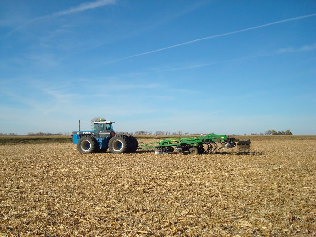

Also put a 3 bar drag on the back. That makes alot of difference

Golden Farms, what brand is that harrow and how do you like it? Got any pics of the finished product running it in that corn ground?

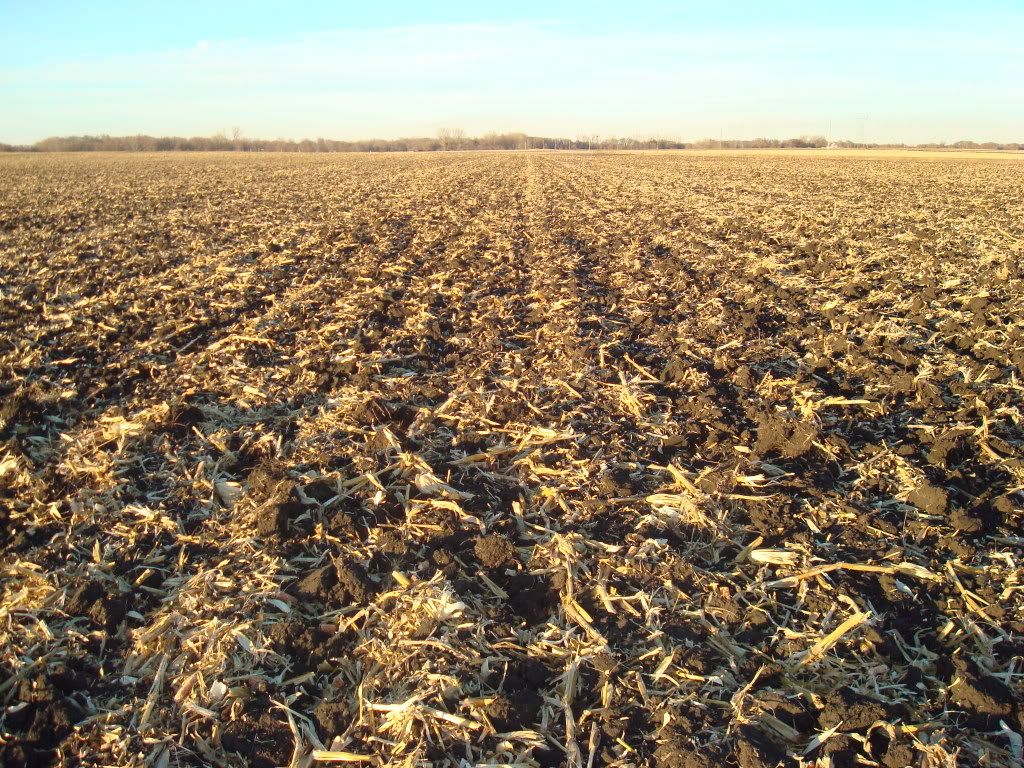

It is Summers harrow. It was well worth the money for it. The drag teeth are 9/16 in thickness and there 24 inches long.

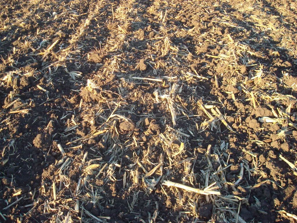

I don't if these pictures do any justice at all. This was the last field I worked for the year and it was getting pretty cold out at the time.

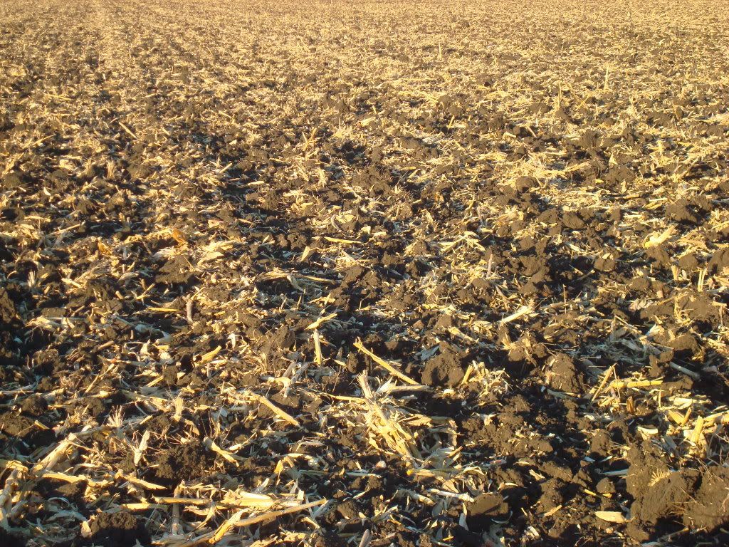

Here are couple more pictures from a field I worked on Nov. 1

That is where I had trouble plugging was right in the middle also. I worked up some CRP with it and that was kind of joke the first time throw and second time it did a pretty good job.

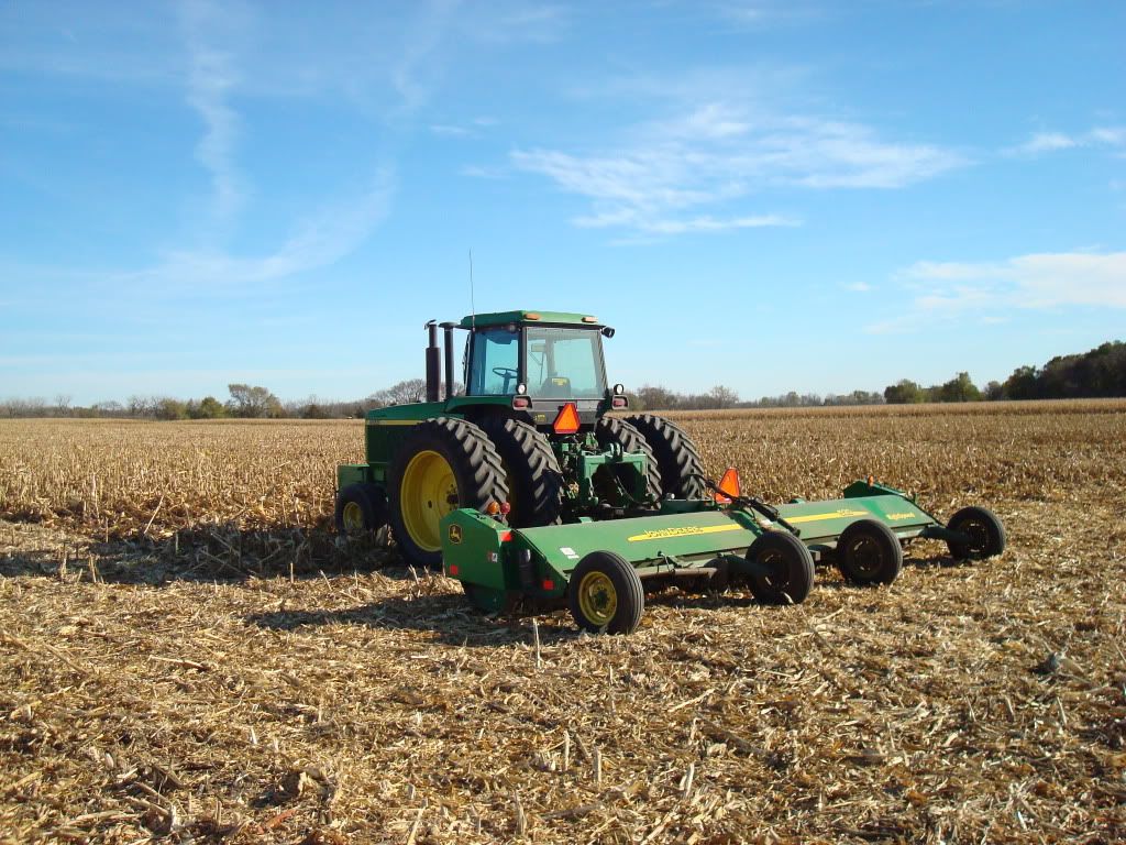

Did you run anything in front of it or is that just how it looks after 1 pass with the 2700? Looks pretty impressive to me.

The stalk chopper most of the time.
Photobucket
JD 520 does an awesome job.
