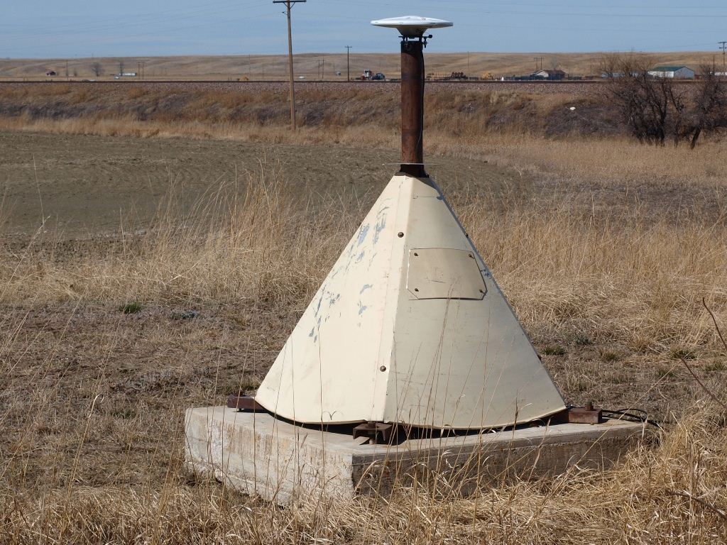

In order to get the 500 to receive RTK, it needs an antenna that receives on both the L1 & L2 bands. It has to be unlocked to first Omnistar and then to RTK. Sticker price on the unlocks is $2K each or $4K to get from WAAS to RTK. Then in order to get RTK, I needed to buy an RTK base station and set that up in a position that had an un-obstructed view of the skies. Needed to be very stable also so this is the mounting point for the station and antenna:
Base station

I started with a 500 unlocked to Omni*. By the time I got the RTK unlock, a used rover radio, data/power cable & antenna for the 500, and then an old unused base station with antenna, cable & wire to hook up to the 900 MHz antenna on the tower I was still under $10K. My base station will supply corrections data to as many receivers as I want and as far as that goes, if the neighbors wanted to use it, they'd be welcome to it at no cost because I'm doing it for myself anyways and it doesn't cost me any extra to share it.
