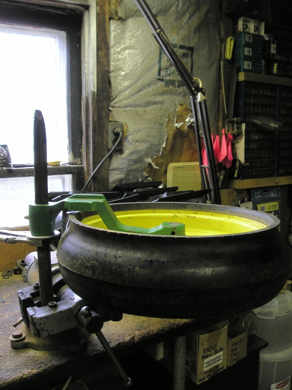

Need to change 8 gauge wheel tires and a couple bearings. How do you get them back together? Looks like it’s going to be a real bear!

Better Than just jumping on them? I use three longer ready rods and thread it together.

What planter and style bearing ?
Older JD planters with stub shaft bearings that attach to the arms can be tricky to get drawn together squarely.
Previous post I made with links to my IE album on this.
https://talk.newagtalk.com/forums/thread-view.asp?tid=93009
For the other style with a pass through bolt style bearing you may find a press style tool helpful. This poster has ads in the classifieds here for this style tool.
https://talk.newagtalk.com/forums/thread-view.asp?tid=686526
Video of tool being used.
https://www.youtube.com/watch?v=LRdETkSlae4
I also see where Shoup is offering a press also.
https://www.shoupparts.com/P2000-Tire-Press/
Others opinions on Ag Talk vary I just never had good luck stomping them together and getting them to run without wobbling. I wanted them to run as close to straight and true as I could make them.
Edit: Once they are mounted stick them on a jig in the vice to evaluate how true they run.

I just use a press. I can do one in a couple of minutes. First press the bearing through which seperates the two metal plates. Flip over, put in new bearing, spray on a lubrication put on top plate and press back together. The only time it takes me a long time is if I am not paying attention and I press it back together and the little holes don't align.

I do the pretty much the same here. I use some plates with 5/8" holes, some bolts to align wheel halves, and use a 5/8" bolt and tap to draw them together. I lube tire beforehand and the bolt threads for drawing together. I still pry around on plastic rim half with screwdriver to get rubber started. Impact makes quick work of it.
Much better than jumping on them.

we made a jig for the press when your doing a bunch you need it easy ive jumped on a bunch or stand on them and use a long screwdriver
