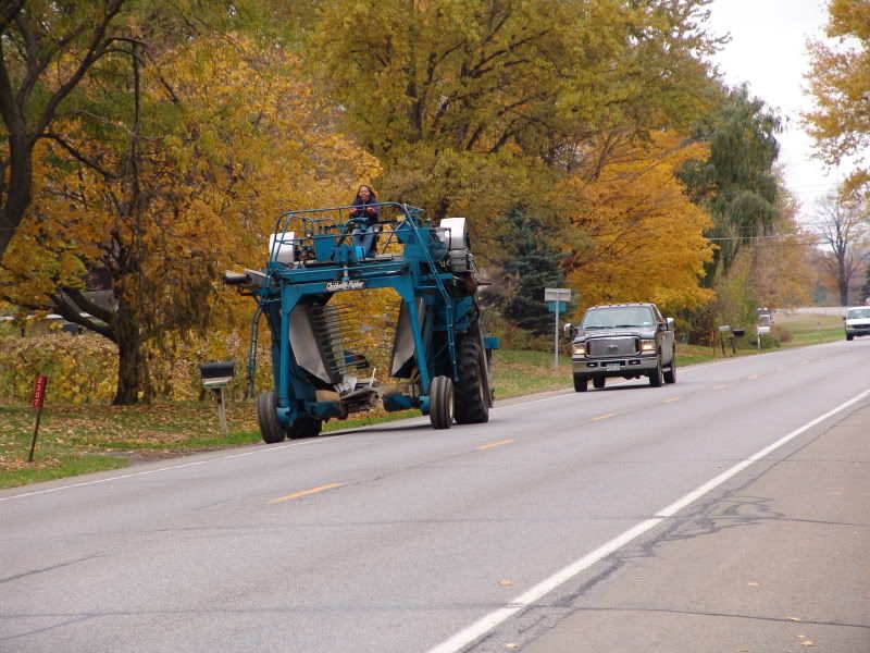

I don't recall posting these before but KelB's Sugercane post made me want to share with you guys. These are a few videos I shot of our grape harvest this year. The blue Korvan is my friends machine and the yellow Gregorie is another friends who is harvesting one of my vineyards.

There are still plenty of Chisholm Ryders around here. The guy who owns the Korvan still owns his older Chisholm Ryder for harvesting his double curtains. The lady driving it is my fiance and it is her dad that owns the Korvan also.
For the most part the newer machines pick cleaner and clean the garbage better then the Chisholms ever dreamed. You do not need a crap picker on these new machines. However, when we ran the Chisholm we needed to have a guy on the harvester picking sticks and such out of the conveyer as the side dump boxes don't have a spot for anyone to stand.
Most of the guys still use lined boxes like you are use to but the bigger guys changed to side dump wagons which hold 4 ton at a time. Two wagons replace 3-4 tractors with bins and there is no messing around changing bins. The side dumps can dump into bins still (you need to level the boxes off by hand though but it is still faster) but to really take advantage of the side dumps you need to go with bulk boxes. The guy who owns the Korvan has three flatbeds with 2 bulk bins on each. Each bulk bin holds 12-13 ton and the processors are set up to dump these bins (they are side dump bins also).

 Your fiance looks like she's got a pretty big smile on her face.  Those things must be fun to drive on the roads.  Must get a lot of funny looks!

This was the first time she has drove the harvester and was smiling because my daughter was out waving to her. I am in the F-250 following.
We get more strange looks driving a combine around here because they are kind of rare as this is grape country. Harvesters are common place on the roads September thru early November.
