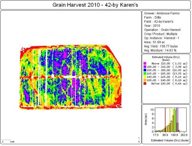

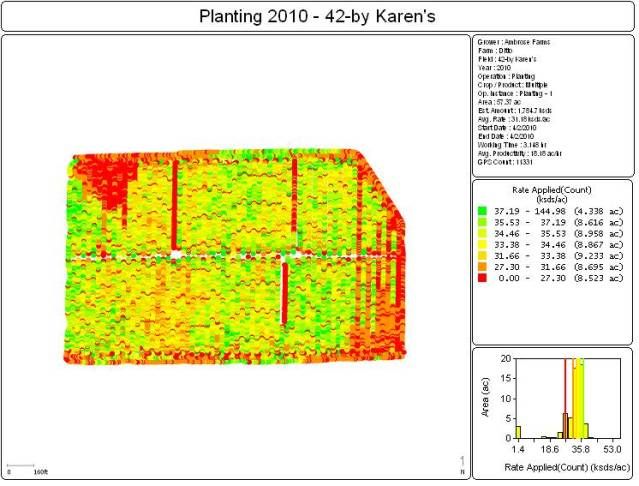

Playing around with my SMS after our 4.6" rain yesterday and just looking at some yield maps. This one is interesting to me for a couple of reasons, first, on the right side you can see on the planted population map where I forgot a few times to flip the rate switch back to high for the irrigated after I had reduced it for the corner and then look at the harvest map. Yep, you can see the end result of that booboo. Also notice the proof that we just couldn't keep stuff watered properly this year with all the heat and drought, this field has a towable pivot that overlaps itself in the center of the 2 pads and that's where you see the best yields. Just thought I'd share.
