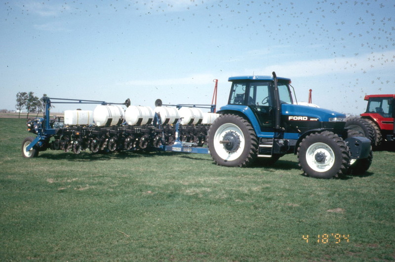

Hopefully these pics load...

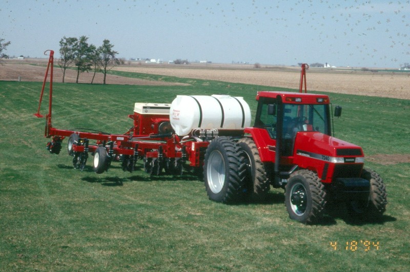

Another view
